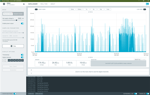

  • Hi Terje,
    Sorry to get back to you so late. I finally got my hands on a PPK2 and for some reason the REPLY buttons are not showing up properly on this forum. I'm measuring the current on my custom nRF52840 board and I'm only using the TWI and SAADC peripherals, which I only turn on and off every 5 minutes to read data from a sensor. This time I'm running with MESH_FEATURE_LPN_ACT_AS_REGULAR_NODE_OUT_OF_FRIENDSHIP=0.
    Other definitions of note:
    /* The maximum duration to scan for incoming Friend Offers. */
    #define FRIEND_REQUEST_TIMEOUT_MS (MESH_LPN_FRIEND_REQUEST_TIMEOUT_MAX_MS) // 1000
    /* The upper limit for two subsequent Friend Polls. */
    #define POLL_TIMEOUT_MS (SEC_TO_MS(10))
    /* The time between LPN sending a request and listening for a response. */
    #define RECEIVE_DELAY_MS (100)
    mesh_lpn_friend_request_t freq;
    freq.friend_criteria.friend_queue_size_min_log = MESH_FRIENDSHIP_MIN_FRIEND_QUEUE_SIZE_16; // 4
    freq.friend_criteria.receive_window_factor = MESH_FRIENDSHIP_RECEIVE_WINDOW_FACTOR_1_0; // 0
    freq.friend_criteria.rssi_factor = MESH_FRIENDSHIP_RSSI_FACTOR_2_0; // 2
    freq.poll_timeout_ms = POLL_TIMEOUT_MS;
    freq.receive_delay_ms = RECEIVE_DELAY_MS;
    Here's what idle looks like:
    Temperature Sensor
    It runs much too high for a button cell so we're deploying them with bigger Li-ions. They've been running fine for more than two weeks but we're concerned about the longevity. Do you think moving to the nRF Connect SDK would see some improvements?
    Arif
    If you zoom in on that current draw plot, I think you will find that the peaks are very narrow spikes of one or two data points. That should be easily mitigated using capacitors, giving less maximum power draw as seen from the batteries.
    The nature of the power draw would be very similar also in nRF Connect SDK, so this would not be a reason for switching. However, there are other reasons for switching, such as the fact the nRF5 SDK is in maintenance mode and new development will happen only in nRF Connect SDK, ref. the nRF Connect SDK and nRF5 SDK statement.
    Terje

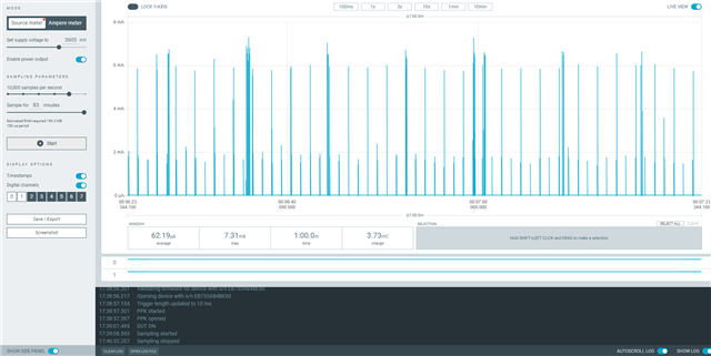

  • We added a 10 uF cap and removed the resistor ladder for the SAADC and managed to get down to this. Very good! Thank you very much for the suggestion. Is there any way to get it down further? The peaks are caused by the friendship polling IIRC, so maybe I should play around with the timings? Right now it'll last 83~ days on a CR2032
