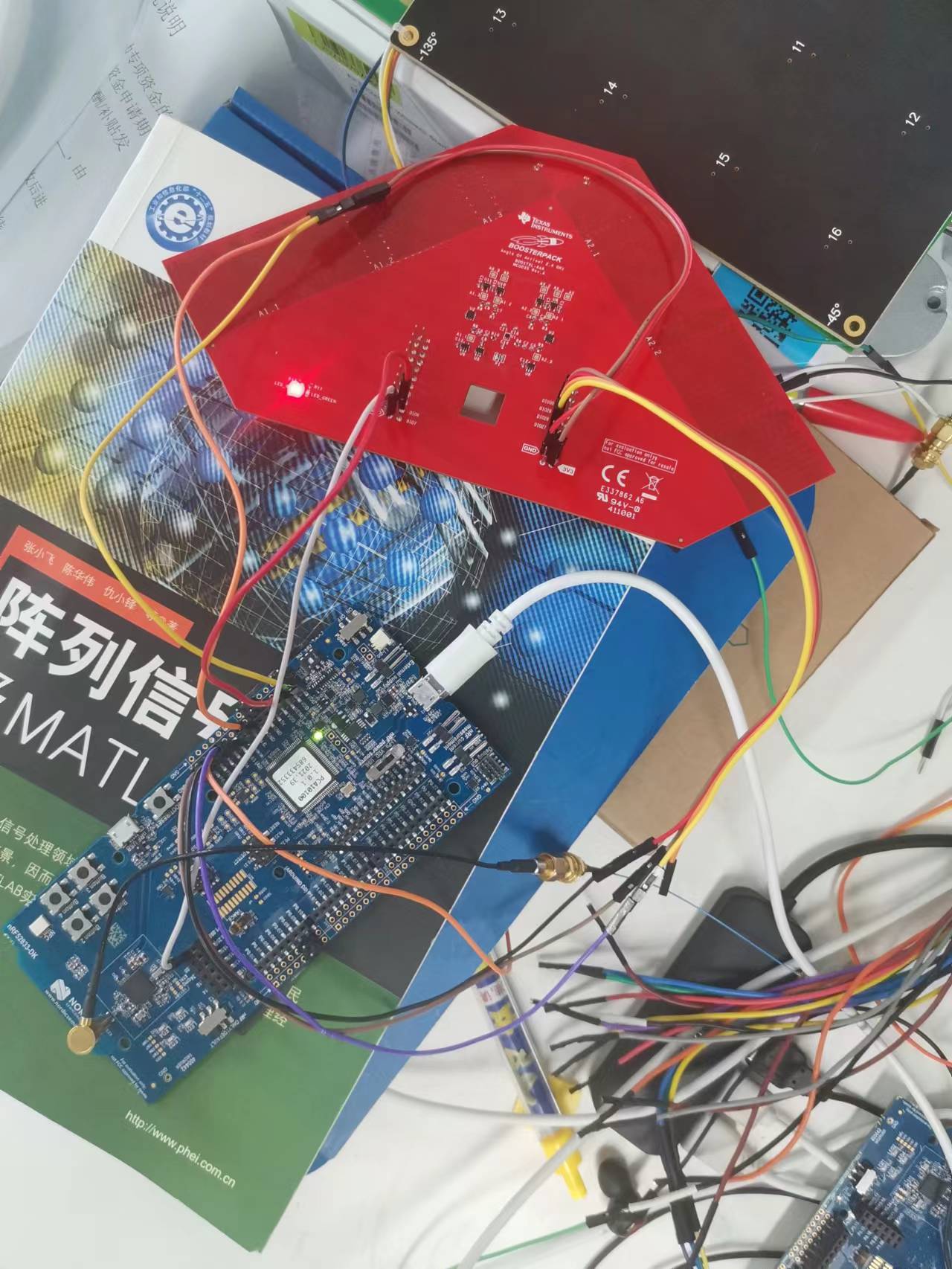

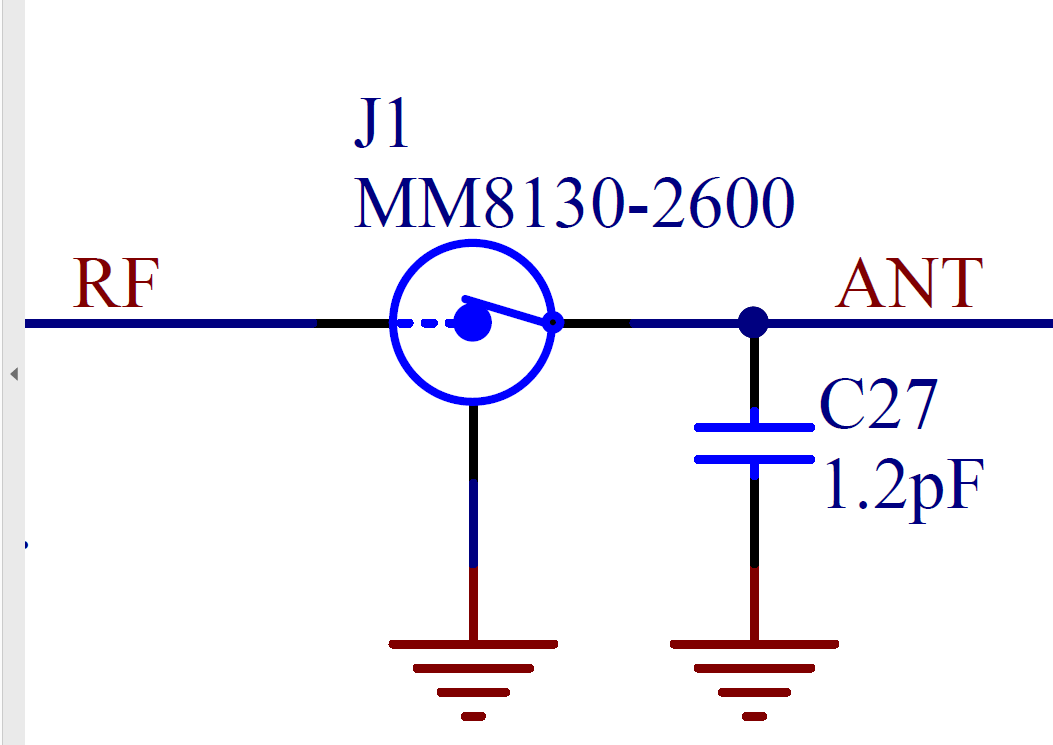

  • I take your suggetion.I study the connector  of  both nrf52833 board and ti AOA antennan array board.i find some problem.because the nrf52833 board has a special cpnnector.it is MM8130-2600.In the most sitution,there is no output about the connection with ti board.i link the board .it has success in work stute,i measure the level of ti board.it has 3.3 V level in.as you see the picture,you can see the how  ti board status.
    1
    the next is my connector if both boards.
    1
    3

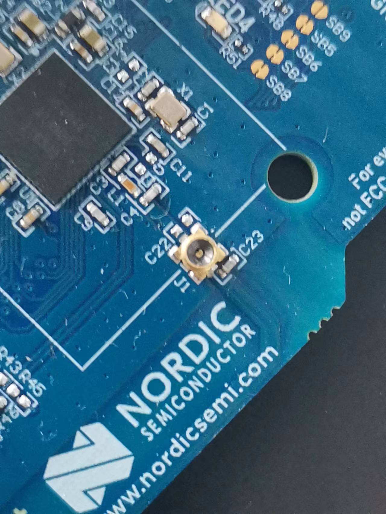

    the next is nrf52833 board the conentor what you see is here.you can make a link to your ti board .what you do and you find you can tell me.
    4
    5
    I think my exeriment have some insufficient.sp i don't have  done my all work.
    i don't build my project and flash the procedure to my boards.so i don't have the iq sample or what in Rx is mentioned.
    thanks for your advice,i decide that i buy an new connector.i wiil try this after spme days.

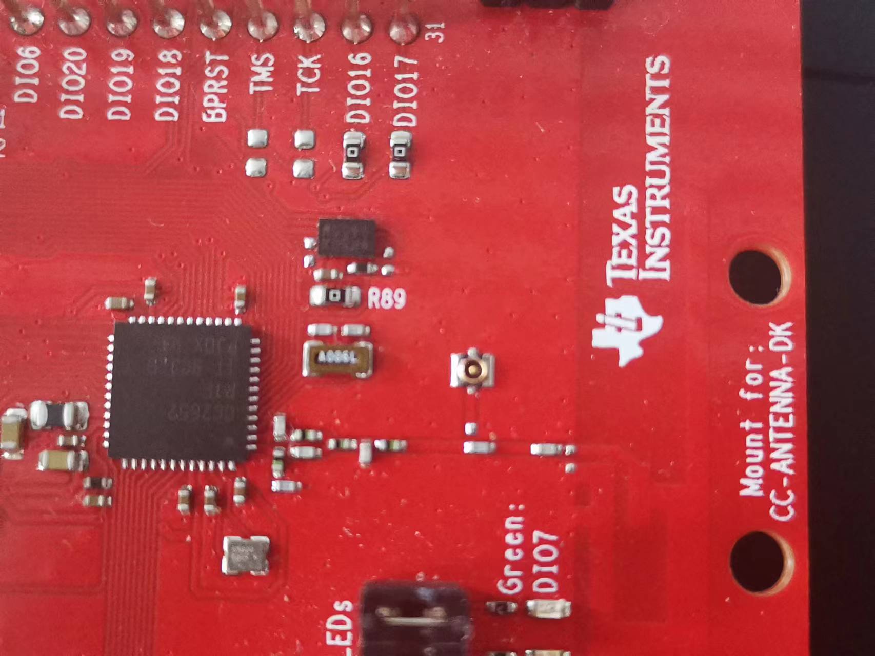

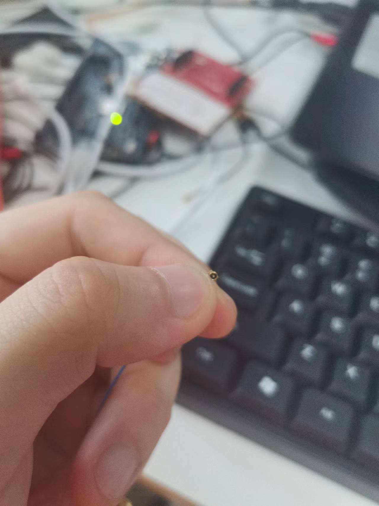

  • Besides this,the ti board connector is here.
    but nordic connector is another kind.it is here.
    2
    i also buy a new turn connetor to link both diffrent board.can you tell me the more information about this connector?
