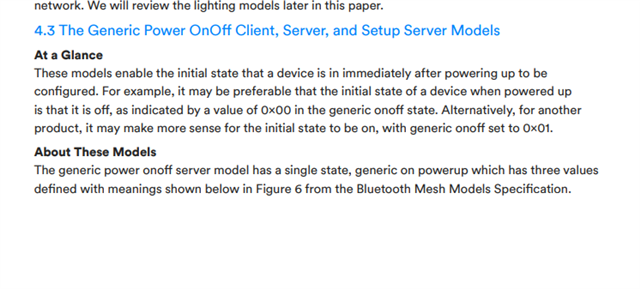

    I am trying to test the system using a generic power onoff client instead of the generic onoff client. I think other Bluetooth mesh echo compatible devices use that model. I have not had any luck getting that model running. Can you help me with that? Is there any example of running the generic power onoff client?

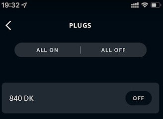

    Some good progress over here. I have managed to connect the light switch server to my echo. It is detected as a plug.
    What functionality is currently not working, is the issue how the device appears on the Echo side? (I.e. it appears as a plug and not as a light? Are you still using the Power On/Off? There might be some heuristics used by the Echo to determine the type of device based on available models.)

    A couple of things to clarify:
    1. If I use the Light switch server sample, it is detected as a plug by the alexa echo device. See capture from the alexa iOS app. This sample implements generic on/off server and generic on/off mc models.

    I was wondering if changing the generic on/off client model to the power on/off client model would change things and the device will be added by alexa environment. What do you think? How can I swap one model for the other?
  • I think trying power on off client it is not going to change much.

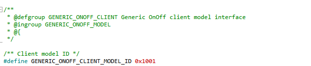

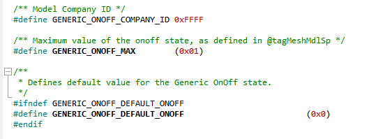

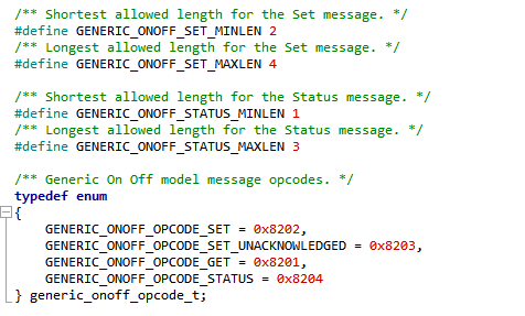

    I think the generic on off client model is the correct mode. I have seen the below defines on the project:
    Do you think that tinkering with one of this defines could make the device to be detected by alexa echo?
