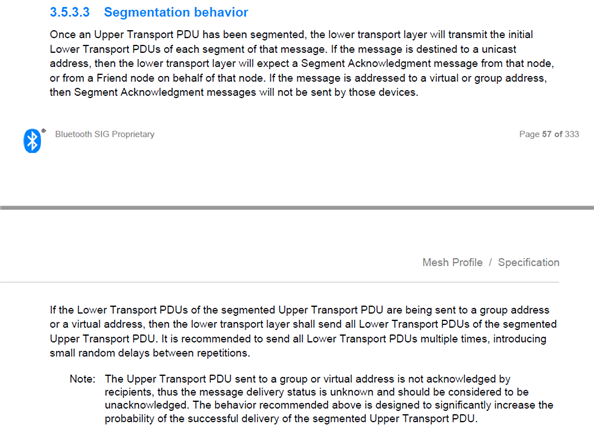

    3. As far as I know they are not related. A proxy node use GATT bearer and relay the message between the phone and the mesh network. It only relays when the message is targeting or from the phone. When the relay node (or relay role) is to relay the any mesh message, from ATT bearer to ATT bearer.
    The difference between sending 100 bytes to one node compare to sending 100 bytes to mutliple node (group address) is that there is no acknowledgement when you send the segmented message to a group address. Here the quote from the Mesh spec:
    This explain why sending the same data to a single node result successful when sending the same message to a group message failed.
