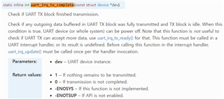

+addition
I found uart_irq_tx_complete() returns '0' for more than 30 sec.(call it every 1 second)
