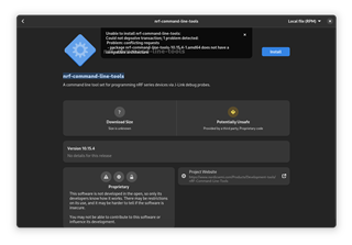

Attempting to install results in an error "package nrf-command-line-tools-10.15.4-1.amd64 does not have a compatible architecture"
