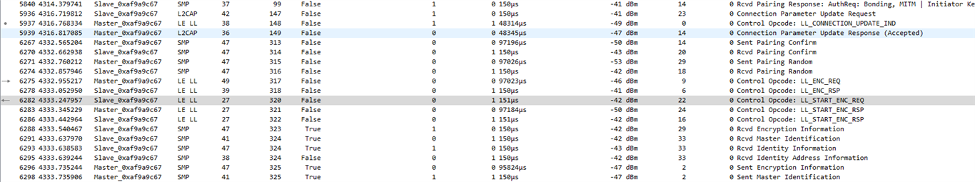

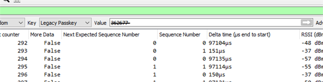

    Next I use my phone to connect and pair, I have to enter the passkey printed on UART (please test using a DK) to the sniffer and the phone.
    After that I can see the initial bonding happen in the sniffer and can see all packets (check the time and packet number):

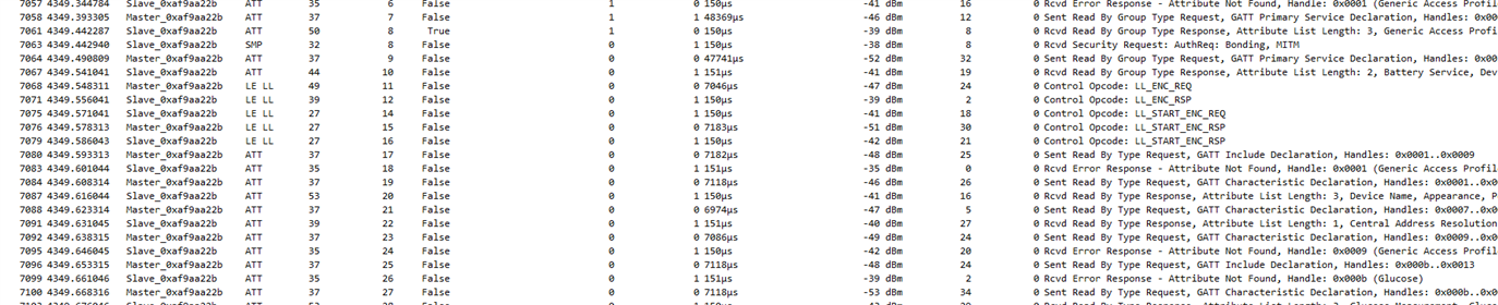

    Then I disconnect then connect again:
    You can see that after the START_ENC_RSP I don't have the "encrypted packet decrypted incorrectly". This means the reconnection and re-encrypt can be decrypted by the sniffer.

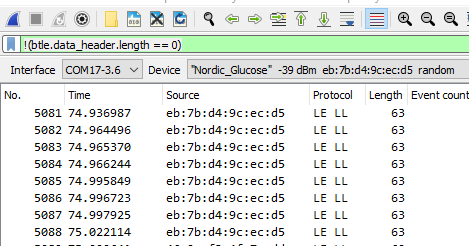

    Before testing please make sure you unplug and plug the dongle and reset wireshark before testing.
    Also you may want to use this filter: !(btle.data_header.length == 0) to filter out empty packets.
