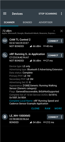

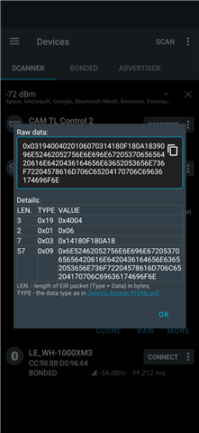

We are using s140_nrf52_6.0.0_softdevice, SDK 15.0.0 for NRF52840 chip. Does this sdk and soft device supports extended advertisement?
I could able to enable this feature but not able to send more than 31 bytes in advertisement packet as the max length is set to 31 and extended advertisement I can see in my sniffer but not full packet.
