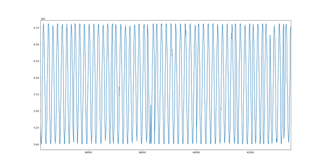

    I managed to print the data. I realized that the amount of print statements has an influence on the data distortion.
    If I print my data in a loop in my data_handler(), the result is an almost perfect sine wave.

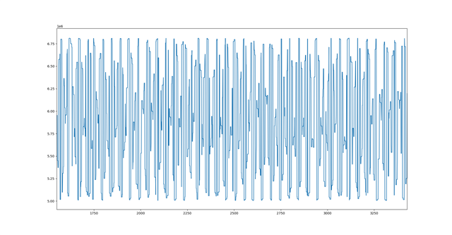

    Printing in the data_handler() AND the queue_data() function will not work (only the prints in the data_handler() will show up), I have to remove the log statement in the data_handler() and add it in the queue_data(). When I plot the data here, the sinus is still recognizable, but already distorted:
    What could be the reason for that?
    My guess is, that while I'm processing the data in queue_data(), the data_handler() is called again and overwrites the data in mp_block_to_check while I'm still processing it.

  • I found the answer to my problem. I used the queue in overflow mode, which caused the data distortion + I think NRF_LOG_INFO() and printf() should be avoided for debugging such issues. It seems they also do not output all the data. However, I also don't know another efficient way to debug this.
