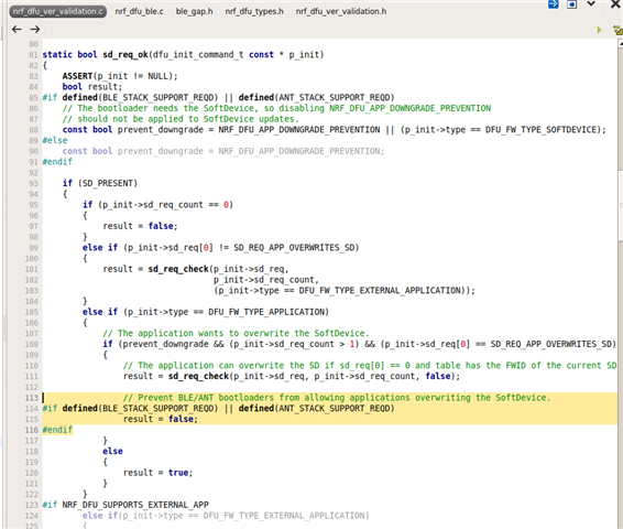

I would like to overwrite my SoftDevice wchich I don't use in my application. I found information about updates without Softdevice.
Its possible to update application without SD? I would like to change start app address from 0x26000 (1st application which contains SD) to 0x1000 (after MBR - 2nd app without SD).
I tried to prepare image pkg with sd-req 0x00
nrfutil pkg generate --hw-version 52 --sd-req 0x00 --application-version 60608 --application app.hex --key-file board_dfu_upgrade_key.pem customer-pkg.zip
I was able to download dfu image but BL didn't activate it.
Could I overwrite SoftDevice by application via DFU or/and should I update BL too?
