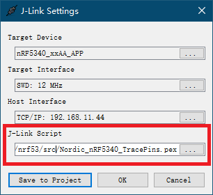

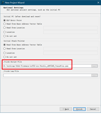

  • Turned off the UART flow control using the switch SW7 from the nRF5340 DK.
  • Debug with Ozone, and configured the Trace Settings
  • After running the program the Instruction Trace view displays No data
When using Nordic_nRF5340_APP_TracePins.zip sample project from Segger the Instruction Trace work properly.
What other modifications should I do in order to be able to debug an application generated by the VScode, using Instruction Trace.
