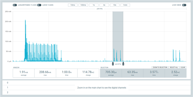

But when I check the PPK output, it seems that the modem stay in DRX state and never enter sleep.

    How are the times in the trace related with the times in the power chart? (I use some additional GPIO to related the times in the PPK II (digital input there) with the modem.)
    So, I'm not sure, what we actually see in the power chart. I would guess, eDRX is negotiated and working, the modem reaches idle, but something keeps the modem from entering eDRX. That requires then a analyze of the trace by Nordic's modem experts to see what happens in that time. But I guess, it will be clearer if the times of the traces can be related to the times of the charts.

  • I started my eDRX experiments with the 1.3.3.  I guess, with that version the reported network timers are the right ones. If eDRX is supported or not seems to be also depending on the used SIM card. With one I don't get eDRX, but with the other one I get it, same network provider, same base station. If the device operates in a network, which supports eDRX, the device doesn't report entering the sleeping mode. But it reduces the power when entering the RRC idle mode.
    That chart is from a device operating in a network supporting LTE-M, eDRX, but no AS-RAI. In the quite phase (RRC idle) it consumes every 20s about 2.5mC (peaks up to 60mA). In the time between this peaks you see the quiescent current of the device including the SIM. In my case, this is about 25µA higher then in power sleeping mode, what is caused by that SIM card. So, if you add all together, eDRX takes 25µA (90mC per hour) and 2.5mC per receive peak (with 20s that's about 450mC), it's 540mC more than PSM. Maybe once softsim is more general available, then it only depends on the interval.
