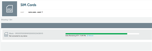

I have an nRF9160 DK revision 1 with ibasis esim.
I wanted to  connect to cloud using the precompiled asset tracker lte files in your website :https://www.nordicsemi.com/Products/Development-hardware/nRF9160-DK/Download?lang=en#infotabs
I tried the nRF9160-DK application and modem firmware latest version (2022-06-02_880c82db) without any success ,the board keep resetting and all leds are off.
I switched to older version( 2020-04-29_bc7ade8b )like in this video : https://www.youtube.com/watch?v=rMvW3HXLErk&ab_channel=NordicSemiconductor
this time Led 3 toggled first then it switches off and Led 4 is on and got this error :nrf_cloud_transport: nct_input: failed -134
this is lte link monitor:
and this is the log file:

    The modem reports that it has not been able yet to connect to a network, which makes it impossible for the nRF9160 to connect to the nRF Cloud.
    2022-08-04T11:19:28.504Z DEBUG modem << +CEREG: 0,"FFFE","FFFFFFFF",7,0,0,"11100000","1110000
    Referring to the documentation of +CEREG for your reference.
    There appears to be an issue with the modem configuration:
    2022-08-04T11:19:28.360Z DEBUG modem << [00:00:00.530,853] [1;31m<err> modem_module: lte_lc_modem_events_enable failed, error: -14[0m
    2022-08-04T11:19:28.375Z DEBUG modem << [00:00:00.530,853] [1;31m<err> modem_module: Failed setting up the modem, error: -14[0m
    But let's start at this point: which SIM card are you using and can you confirm that it is activated?

  • Hi Albrecht,
    I use iBasis sim card and yes it's activated
    Ok thanks, Mourad!
