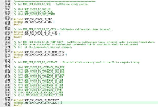

At present, our products have started production, but customers have reported three Bluetooth problems, which need technical assistance from Nordic to solve them as soon as possible.Using SDK17.1 flash_s140_nrf52_7.3.0_softdevice.
1、gatt error
For this problem, I modified xtal_accuracy according to some posts on the forum. The same is true. There will be an error 133 when the mobile phone applies for a connection, so is there any other solution for this?
