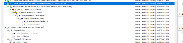

E 13:52:10.541 [DFU] Error (0x85): GATT ERROR

I have tried using iOS device but on it I am also getting error
what am I doing wrong? What I have missed?

    I have tried the same thing that you suggested with debug version and able to observe logs. (BTW I replaced libnrf_cc310_bl_0.9.13 from original to the nRF5_SDK_17.1.0_ddde560\nRF5_SDK_17.1.0_ddde560\external\nrf_cc310_bl\lib\cortex-m4\hard-float\no-interrupts\ library since i use IAR 8 and hit wchar error on linkage).
    Here is a device side Log (From RTT):

    <debug> nrf_dfu_req_handler: Handle NRF_DFU_OP_OBJECT_SELECT (command)
    <debug> nrf_dfu_req_handler: Request handling complete. Result: 0x1
    <debug> nrf_dfu_ble: Set receipt notif
    <debug> nrf_dfu_req_handler: Handle NRF_DFU_OP_RECEIPT_NOTIF_SET
    <debug> app: Shutting down transports (found: 1)
    <debug> nrf_dfu_req_handler: Handle NRF_DFU_OP_OBJECT_CREATE (command)
    <debug> app: timer_stop (0x20005978)
    <debug> app: timer_activate (0x20005978)
    <debug> nrf_dfu_ble: Buffer 0x20006EC4 acquired, len 141 (244)
    <debug> nrf_dfu_req_handler: Handle NRF_DFU_OP_OBJECT_WRITE (command)
    <debug> nrf_dfu_ble: Freeing buffer 0x20006EC4
    <debug> nrf_dfu_req_handler: Handle NRF_DFU_OP_CRC_GET (command)

  • and here is an air trace (btt file) that is related to the my today's reply (logs from device and Android phone)dfu.btt

  • Hi Igor,
    Thanks for the information and the sniffer trace.
    From what I can see in the log and the trace, I suspect that the bootloader crashed at some point right after the execute command (0x04) from the central when the init packet is sent. You can see the sequence here:
    https://infocenter.nordicsemi.com/topic/sdk_nrf5_v17.1.0/lib_dfu_transport_ble.html?cp=8_1_3_5_2_2_3_0#lib_dfu_transport_msc_init
    In the sniffer trace you can see that there was no response after the command (0x04) :
    Because there was no response after the write request, you receives a GATT ERROR.
    What you can do is to check if the same problem can be reproduced on the stock bootloader example. Please try to test without the application, only softdevice  + bootloader.
    Do you use WDT in your application ? If you do have there could be a chance that the WDT was not handled properly in the bootloader and cause a reset.
    If you can reproduce the issue on an unmodified bootloader (test without application ) we can test here and check if there is any problem with it. Please also do a cross check with the unmodified bootloader from SDK v17.0 .
