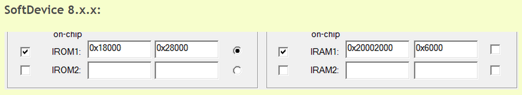

    • open ble uart app in keil and in "Target Options"and check IROM and IRAM settings like below
    image description
    • compile and flash ble_app_uart If the LED is blinking then your device is advertising. Then follow instructions of that APP here
