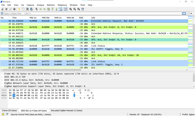

After the connection between the light-bulb and the Zigbee-Coordinator is completed, it is observed from Sniffer that both parties will broadcast regularly (as shown in the screenshot below), and there are some questions:
1. Is there a way to describe the 5bytes payload?
2. What are the functions of the broadcast packets on both sides?
    1. If you start the sniffer before the router is commissioned by the commissioner, the sniffer will capture the transport key that is exchanged on-air during commissioning process. You will then be able to see much more details about the packets and content in Wireshark. I have attached an example:
    2. The broadcast packets you see are "Link Status" messages sent by the stack with information about the node's neighbors and incoming/outgoing link cost. You can read more about this in the Zigbee Network specifications (Link Status Messages).
