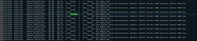

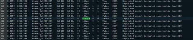

    Thank you for your reply! You are most probably right, changing to a device that we know supports Bluetooth 5 and therefore, 2MBPS PHY, seems to make the change the right way. However, there is still a delay that we find suspicious. We understand that for every package there should be approximately an inter frame space (IFS) delay between packets of 150us, which we see in the screenshots, but the delays occurring in the Empty PDUs' time sent from the Master are way too big compared to the delays in nRFConnect.
    BLE Application:
    nRFConnect:
    As you can see, the delays in the application are even 10 times the nRF. Any idea of the cause behind this phenomenon? I also attach the wireshark traces:
    nrfConnect_2M_wireshark_333.pcapng
    application_2M_delays.pcapng
    Best regards.
  • Hi
    Well, this time is the time from the end of the last packet to the start of this packet, so this time will also include any processing on the Master side, since the Master is the source of this longer delay the processing on the computer side is longer than for the nRF. Likely because a computer has stricter timeslots for BLE activity and more processing between BLE events.
