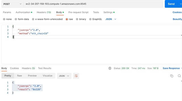

We are trying to send an HTTP request to our AWS Web Server.
The problem that we are figuring out now is that we don't know the way to add a body to our request.
We based our code on the Connection Example provided by Nordic (https://developer.nordicsemi.com/nRF_Connect_SDK/doc/latest/nrf/samples/nrf9160/https_client/README.html), but It doesn't work. Sometimes we have no response and sometimes we obtain a "BAD REQUEST" response from the server.
#define BODY  "{ \"jsonrpc\": \"2.0\", \"method\": \"eth_chainId\" }"
#define HTTP_HEAD "POST HTTP/1.1\r\n"\
		"Host: "HTTPS_HOSTNAME"\r\n"\
		"Connection: close\r\n"\
	    "Content-type: application/json\r\n"\
		""BODY"\r\n\r\n"
We need your help! Thank you!

    I still don't see any URL between the request method (POST) and the protocol version (HTTP/1.1)
  • This is the URL #define HTTPS_HOSTNAME "ec2-184-73-45-204.compute-1.amazonaws.com"
    If I make the same request on PostMan it runs!
  • No, that is the hostname. You also need the path to the resource you want to get/modify.
    Try add a '/' between the request method and the protocol version (separated by spaces), if you want  to modify the root object.
  • We tried to add a "/" but we have the same error. This is the exact request that we make on Postman.
