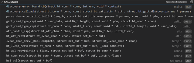

    I suggest focusing on that bt_conn_set_security() returns -ENOMEM. Did you try to increase CONFIG_BT_MAX_PAIRED? Or can you try to dig deeper with a debugger to pinpoint  more closely where the error originates?
    This might be more detailed information for ELECOM mouse errors.
    (1) Sniffer trace (decrypted) (2) Call stack (3) Debug log
    I guess I need to set a larger buffer size somewhere as the last part of the log below says
    (BT_MAX_PAIRED, BT_GATT_DM_MAX_ATTRS, BT_HOGP_REPORTS_MAX are not the answer to resolve the problem)

    D: handle 0x0018 uuid 2a4e properties 0x06
    The discovery procedure failed with -3

  • I am not able to pinpoint the exact issue from here. Have you attempted to debug to see exactly where the error comes from? Which API call returns -ENOMEM, and how far down can you track it? That should give a good indication on what needs to be adjusted.
  • I found that the error comes from L417 "discovery_process_characteristic" in gatt_dm.c https://github.com/nrfconnect/sdk-nrf/blob/v2.1.0/subsys/bluetooth/gatt_dm.c#L417
    However, this is not the reason why the Central HIDS example does not work with ELECOM mouse. Below is a list of attributes stored during the connection. In Logitech, all handles are stored sequentially, while ELECOM lacks some handles. This is a variation of behavior among BLE peripherals.

    ### (parse_characteristic) handle: 0x0018, uuid: 2a4e, properties: 0x06
    ### (bt_gatt_dm_attr) look for an attr with handle: 0x0018
    ===> It fails as handle 0x0018 does not exist.
    Why, this happens? I capture BLE packets (1) ELECOM + Central HIDS example (2) ELECOM + iPad. The example reads GATT database by "Find Information 0x04", while iPad does by "Read by Type 0x08". (See details in the attached files. You need filter ATT packets by "btatt".) I also found that Windows 10 also use "Read by Type". This causes the lack of information in the Central HIDS example.
    So, I wan to change the method to read GATT database by not "Find Information" but "Read by Type" like iPad does. How can I do this?
