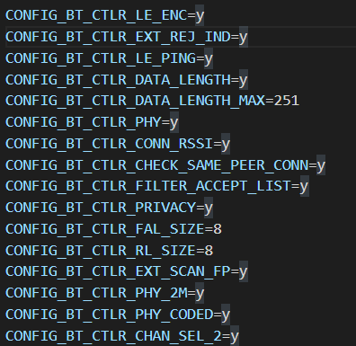

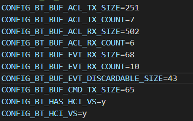

    To maximize throughput, you need to change the default Bluetooth controller settings on the network core (i.e. kconfig settings for hci_rpmsg). And to change those configurations, you have to include the configuration file I provided.
    Configurations settings for hci_rpmsg to support 251 byte Radio packets:
    - CONFIG_BT_BUF_ACL_TX_SIZE=251
    - CONFIG_BT_BUF_ACL_RX_SIZE=251
    - CONFIG_BT_CTLR_DATA_LENGTH_MAX=251
    And the configurations from your current build (copied from the .config file in your build/hci_rpmsg/zephyr folder):
    CONFIG_BT_CTLR_LE_ENC=y
    CONFIG_BT_CTLR_EXT_REJ_IND=y
    CONFIG_BT_CTLR_LE_PING=y
    CONFIG_BT_CTLR_DATA_LENGTH=y
    CONFIG_BT_CTLR_DATA_LENGTH_MAX=27
    CONFIG_BT_CTLR_PHY=y
    CONFIG_BT_CTLR_CONN_RSSI=y
    CONFIG_BT_CTLR_CHECK_SAME_PEER_CONN=y
    CONFIG_BT_CTLR_FILTER_ACCEPT_LIST=y
    CONFIG_BT_CTLR_PRIVACY=y
    CONFIG_BT_CTLR_FAL_SIZE=8
    CONFIG_BT_CTLR_RL_SIZE=8
    CONFIG_BT_CTLR_EXT_SCAN_FP=y
    CONFIG_BT_CTLR_PHY_2M=y
    CONFIG_BT_CTLR_PHY_CODED=y
    CONFIG_BT_CTLR_CHAN_SEL_2=y
    CONFIG_BT_BUF_ACL_TX_SIZE=27
    CONFIG_BT_BUF_ACL_TX_COUNT=7
    CONFIG_BT_BUF_ACL_RX_SIZE=27
    CONFIG_BT_BUF_ACL_RX_COUNT=6
