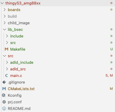

  • Hi Hieu,
    Finally, I found what I missed, and I want you to know how I solved the problem.
    My very first "CMakeLists.txt" includes ExternalProjectAdd() cmake command.
    This cmake command can add external static library with *.c and *.h files coded by the user. But, this command needs to know the *.c and *.h file's directory which includes Makefile of the source and header file. Here is the Makefile of its directory.
    PREFIX ?= .
    OBJ_DIR ?= $(PREFIX)/obj
    LIB_DIR ?= $(PREFIX)/lib
    all:
    	mkdir -p $(OBJ_DIR) $(LIB_DIR)
    	$(CC) -c $(CFLAGS) -MD -Iinclude src/gt2_grideye.c -o $(OBJ_DIR)/gt2_grideye.o
    	# $(CC) -c $(CFLAGS) -MD -Iinclude src/gt2_environment.c -o $(OBJ_DIR)/gt2_environment.o ./include/libalgobsec.a
    	$(CC) $(CFLAGS) -MD -Iinclude src/gt2_environment.c -o $(OBJ_DIR)/gt2_environment.o
    	$(CC) -c $(CFLAGS) -MD -Iinclude src/gt2_ble_service.c -o $(OBJ_DIR)/gt2_ble_service.o
    	$(AR) -rcs $(LIB_DIR)/lib_gt2.a $(OBJ_DIR)/*.o
    clean:
    	rm -rf $(OBJ_DIR) $(LIB_DIR)
    This Makefile makes a static library named "lib_gt2.a". I succeed to link "lib_gt2.a" to my main project and it worked properly. The "gt2_environment.c" uses bsec library, I need to let the gt2_environment.c know where the static library is. However, when I tried to link "libalgobsec.a" with this makefile, by adding "./include/libalgobsec.a -lm" to end of the "~~gt2_environment.o" line, Makefile and the gcc complier only said that they can't find bsec libraries.
    Like this, the Makefile does not find zephyr and nrf-sdk specific headers. Because the zephyr based project is managed by "cmake", specific directories' specific makefile isn't good to link external library.
    So, I restructured my project's code tree, and I finally could compile the project.
    Here is my new CMakeLists.txt and my new directory structure.

    # BSEC static library configuration
    zephyr_library_import(lib_bsec ${CMAKE_CURRENT_SOURCE_DIR}/lib_bsec/src/libalgobsec.a)
    target_include_directories(app PUBLIC ${CMAKE_CURRENT_SOURCE_DIR}/lib_bsec/include)
    target_link_libraries(lib_bsec INTERFACE kernel)
    target_link_libraries(app PRIVATE lib_bsec)
    # add_library(lib_bsec STATIC IMPORTED GLOBAL)
    # set_target_properties(lib_bsec PROPERTIES IMPORTED_LOCATION                     ${CMAKE_CURRENT_SOURCE_DIR}/lib_bsec/src/libalgobsec.a)
    # set_target_properties(lib_bsec PROPERTIES INTERFACE_INCLUDE_DIRECTORIES         ${CMAKE_CURRENT_SOURCE_DIR}/lib_bsec/include)
    # target_link_libraries(app PUBLIC lib_bsec)
    I located custom *.c and *.h files to the "src" directory where the "main.c" is located. And edited the CMakeLists.txt to let it know where the custom files are by using "target_include_directories" and "target_sources".
    I hope this issues is useful to someone who want's to include external libraries and custom source and header files at one time.
    Best regards.
    Kang. H.M.
    ps. I succeed to compile, flash and debug, the device logs that the thread with the bsec library had stack overflow. Now, I have to figure out where the stack overflow comes from Slight smile
