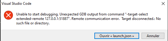

    I tried entering debug mode but i have this message :
    and with rtt viewer i have nothing also, i connect to my device.
    Which project did you run with RTT? Did you run the hello_world that I previously recommended you to do?
    Yes i run the one that you recommanded me

    You can try to set the above configurations, in addition to the RTT specific configurations, in hello_world to see if you can get RTT to work now as well.
    Håkon
  • Indeed with this configuration RTT works fine, really thanks you.
