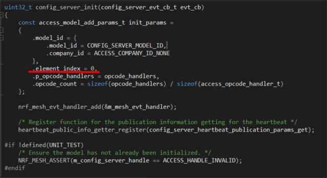

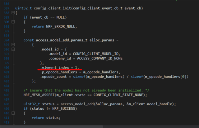

Hello! I have a similar problem. However, it manifests itself under other conditions. I have a node that has a configuration client and a configuration server at the same time, and it is convenient for me to use the configuration client to configure other models on the same device. All the functionality of the configuration client works well, I send messages to the server, the configuration happens and I get a status message back, but not a message about setting the publish address. I found out that the message with the 0x03 opcode is successfully received by the server, processed and it sends a response (send replay). But the access layer does not receive this status message and, accordingly, I receive a callback on the timeout event. Please help solve this problem! Thank you!
