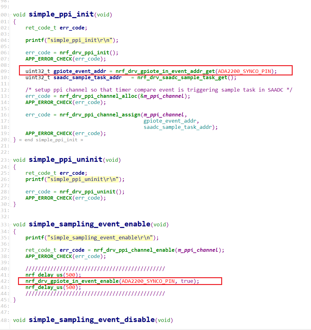

    Even though you are sampling this at 62.5kHz, you should not need to execute an MCU interrupt at this interval. Much of the point of having PPI and EasyDMA is to offload the MCU for the real-time requirements, and instead the MCU only need to actively handle "lump" of data, not on a byte level, but on an array of data. So my suggestion here is that you change SIM_SAMPLES_IN_BUFFER from 1 to 10. Then the MCU will be interrupted every 6.25kHz to process 10samples, instead of 1 sample every 62.5kHz.
    Kenneth
    You said:
    " Even though you are sampling this at 62.5kHz, you should not need to execute an MCU interrupt at this interval. Much of the point of having PPI and EasyDMA is to offload the MCU for the real-time requirements,......"
    So I followed your advice and deleted the [interrupt function] as in the following code.
    By the way, simple_voltage_handler() is not called. Why?

    void simple_ppi_init(void)
        ret_code_t err_code;
    	printf("simple_ppi_init\r\n");
        err_code = nrf_drv_ppi_init();
        uint32_t gpiote_event_addr = nrf_drv_gpiote_in_event_addr_get(ADA2200_SYNCO_PIN);
        uint32_t saadc_sample_task_addr   = nrf_drv_saadc_sample_task_get();
        /* setup ppi channel so that timer compare event is triggering sample task in SAADC */
        err_code = nrf_drv_ppi_channel_alloc(&m_ppi_channel);
        err_code = nrf_drv_ppi_channel_assign(m_ppi_channel,
                                              gpiote_event_addr,
                                              saadc_sample_task_addr);
    void simple_ppi_uninit(void)
    	printf("simple_ppi_uninit\r\n");
        err_code = nrf_drv_ppi_uninit();
    void simple_sampling_event_enable(void)
    	printf("simple_sampling_event_enable\r\n");
        ret_code_t err_code = nrf_drv_ppi_channel_enable(m_ppi_channel);
    	nrf_delay_us(500);
    	nrf_drv_gpiote_in_event_enable(ADA2200_SYNCO_PIN, true);
    	nrf_delay_us(500);
    void simple_sampling_event_disable(void)
    	printf("simple_sampling_event_disable\r\n");
    	nrf_drv_gpiote_in_event_disable(ADA2200_SYNCO_PIN);
    	ret_code_t err_code = nrf_drv_ppi_channel_disable(m_ppi_channel);

    Looking at the source code, is the processing of the 62.5KHz external clock pin (ADA2200_SYNCO_PIN) in the red box normal?
    Regardless of MCU, it should receive an external clock of 62.5KHz and PPI should perform ADC sampling on its own, but it doesn't work that way.
