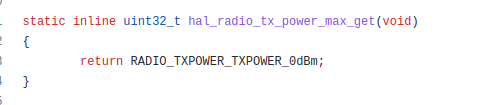

    I have seen that in hal/nrf5/radio/radio_nrf5340.h
    Which says the maximum power is 0dbm. Then how the 3dbm can be configured?
  • Hi mapg,
    That is a very interesting discovery. I will have to double check with the internal team on why that file is implemented like that and if it affects anything. My quick check shows that it is probably an error of the author, and it shouldn't affect anything.
