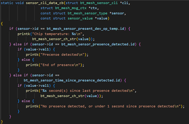

I tried bluetooth mesh sensor server and client example, everything is good including provisioning process in mobile but the output is different with different mobiles. i have 2 mobiles where i tested in both mobiles i get output of this part as shown in picture-1
picture-1
and
picture-2
and from the picture-2 of code except chip temperature i can see other printk functions in output.
I tried this in my colleague mobile in that i can see picture-2 outputs but not picture-1 output.
I am really confused, why this happens? Can anyone help me as soon as possible please...

  • SaSu said:
    1. printk("chip temperature : ........") from sensor_cli_data_cb is not printing.
    But have you debugged to see if the sensor_cli_data_cb() is actually being called?
  • 1. Yes its calling how i know is, when i press button on thingy-53,
    else if (sensor->id ==
               bt_mesh_sensor_time_since_presence_detected.id) {
            if (value->val1) {
                printk("%s second(s) since last presence detected\n",
                       bt_mesh_sensor_ch_str_real(value));
            } else {
                printk("No presence detected, or under 1 second since presence detected\n");
            }    This part is being executed and i can see output of "%s second(s) since last presence detected" on PuTTY screen also if i don't press i can see "No presence detected, or under 1 second since presence detected".
    2. FYI,
             if (sensor->id == bt_mesh_sensor_present_dev_op_temp.id) {
            printk("Chip temperature: %s\n",
        } else if (sensor->id == bt_mesh_sensor_presence_detected.id) {
            if (value->val1) {
                printk("Precense detected\n");
            } else {
                printk("End of presence\n");
            }   This part is not being executed, I also cannot see "Precense detected" and "End of presence" along with "Chip temperature"

  • You need to understand that I don't have your application files, so these snippets mean nothing to me. Are they in the same function?
    Why should the last part be called? Where is it called from? is (sensor->id == bt_mesh_sensor_present_dev_op_temp.id) returning true?

  • Ok, so I see that you have the callback function in you sensor_client:
    static void sensor_cli_data_cb(struct bt_mesh_sensor_cli *cli,
    			       struct bt_mesh_msg_ctx *ctx,
    			       const struct bt_mesh_sensor_type *sensor,
    			       const struct sensor_value *value)
    		if (value->val1) {
    		} else {
    		if (value->val1) {
    		} else {
    If you set a breakpoint inside sensor_cli_data_cb, is this ever triggered?
    And if it does, is sensor->id equal to bt_mesh_sensor_present_dev_op_temp.id?
