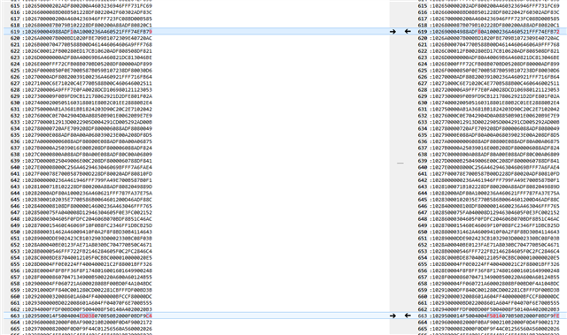

  • Hi Edvin,
    My privies replay gives only partial log,
    Please check the attached one for full RTT Viewer log for successful DFU process with nRF52833 DK board.

  • Hello Sudheer,
    Thank you for the detailed logs. If the last log also contain the debug bootloader, apparently it doesn't start the bootloader. But then again, the bootloader didn't log anything before starting the app the first time either, which is kind of strange.
    Did you build the bootloader in an IDE? Can you try to set a breakpoint inside the bootloader and see if it hits (both before the app starts and after you try to reset into DFU mode?
    And finally, can you please read out the flash of both the DK and the custom board? For this you can use the command:
    nrfjprog --readcode my_hex_dump.hex
    And upload these files here. I can't say what's actually going on there, just by looking at the .hex files, but I can compare the two to see whether all the components are present.
    Edvin
  • Hi Edvin,
    Yes, build it successfully!
    little time is required to address this
    Her you will get the nRF52833DK board flash hex file
    my_DKboardhex_dump.hex
    And Here is Custom board flash hex file
    my_customhex_dump.hex
    Sudheer
  • Those are almost identical. What I find strange is that there are two lines that are different in the two hex files that you sent. On line 619 and 663. Both of these locations are inside the softdevice, and they should not change at any point. Does your application do any flash operations (fstorage) other than FDS at some point?
    Also, apparently, the UICR is not included in the flash dump. Can you please try to read out a register for me on both your devices?
    nrfjprog --memrd 0x10001014
    What do they say?
  • The differences are these by the way (marked in red):
    Are the values something you recognize?
