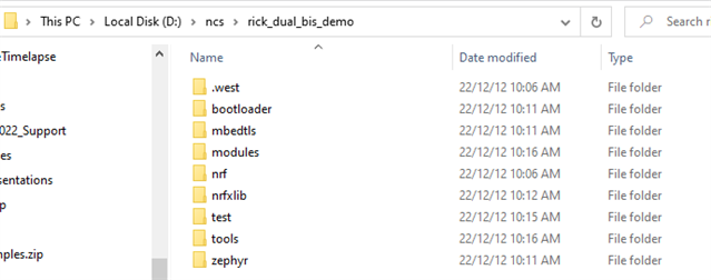

    I install the SDK at nrf Connect, but this gateway-demo is placed in a different folder named nordic_devzone. Is this a problem? Should I make some changes in the root folder?
    What is the difference/necessity of the nrf-folder?
    Asbjørn
  • Hi Asbjørn
    The top folder (the one containing the other subfolders like nrf, zephyr etc) can be named anything you like, but the nrf folder itself should not be renamed.
    As an example this is how it looks for me:
    I created a new folder called D:\ncs\rick_dual_bis_demo, and then I ran the earlier mentioned west commands from within that folder to set up a new nRF Connect SDK instance based on Rick's changes.
    The nrf repository/folder is the manifest repository, which means it contains the manifest file that west uses to download the right version of the various other repositories, including Zephyr.
    It also contains most of the Nordic unique libraries and samples, such as the 5340 LE Audio application.
