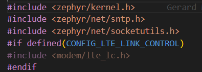

I'm implementing a SNTP sync over Ethernet and found the following issues:
1- CONFIG_DATE_TIME_AUTO_UPDATE must be disabled to get a NTP time sync scheduling:
void date_time_core_init(void)
if (IS_ENABLED(CONFIG_DATE_TIME_AUTO_UPDATE) && IS_ENABLED(CONFIG_LTE_LINK_CONTROL)) {
lte_lc_register_handler(date_time_lte_ind_handler);
if (!IS_ENABLED(CONFIG_DATE_TIME_AUTO_UPDATE)) {
date_time_core_schedule_update(false);
2- date_time_ntp.c module uses a predefined servers and is not related with SNTP config (CONFIG_NET_CONFIG_SNTP_INIT_SERVER)
#define UIO_NTP "ntp.uio.no"
#define GOOGLE_NTP "time.google.com"
#define NTP_PORT 123
static const char * const servers[] = {
UIO_NTP,
GOOGLE_NTP
