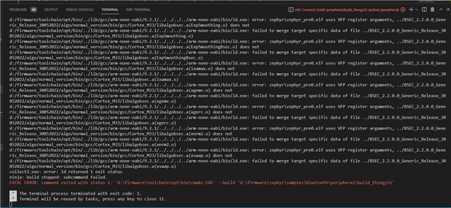

  • I followed every step as rtlab said.
    I am facing  error  " error: '../libs/lib_bsec/src/libalgobsec.a', needed by 'zephyr/zephyr_pre0.elf', missing and no known rule to make it"  when I add these lines in my CMake
     zephyr_library_import(lib_bsec ${CMAKE_CURRENT_SOURCE_DIR}/libs/lib_bsec/src/libalgobsec.a)
     target_include_directories(app PUBLIC ${CMAKE_CURRENT_SOURCE_DIR}/libs/lib_bsec/include)
     target_link_libraries(lib_bsec INTERFACE kernel)
     target_link_libraries(app PRIVATE lib_bsec)
    I am on step of adding  bsec_sensor_control(); to my file
  • The error indicates that the library was not found. Maybe the library path is incorrect. Either way, please try to link in the library like I did in this modified hello world sample:

  • Hi
    Thank you for being so helpful
    I have tested according to your suggestion, and now that error is resolved but facing another error
    Please have a look at my CMake list now

    The linker errors indicate that your app is built with the FPU enabled. In that case, you must use the FPU enabled variant of the library located in /algo/normal_version/bin/gcc/Cortex_M33and not the one in /algo/normal_version/bin/gcc/Cortex_M33.
  • Thanks, now the build is successful,

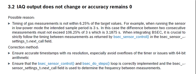

    The modified bme688 file is attached below, there are two problems
    1. CPU is not recognising if(status == BSEC_OK) as true, so therefore not moving in.
    2. When I am printing the iaq = output[i].signal;  it is showing the 50 value constantly, I have observed that the gas resistance is Constant all the time at  12917167

    Edited:- I read in the docs bsec_bme_settings_t::next_call field is used to determine the frequency between measurements.   Please goto line 71 in above file,you will see I have only added run_gas[1], should I need to add more, If yes then what to add and what to write in the respective fields
