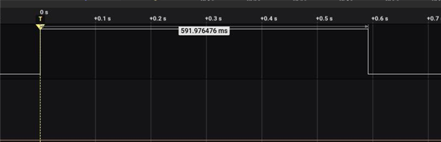

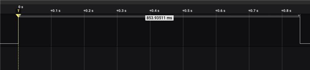

I was able to significantly reduce the startup time now by disabling boot validation that takes place on every reboot by default, and by changing the default clock configuration.
Here are my results:
#1 with RCOSC as LF clock source
Settings added to MCUBoot build:
