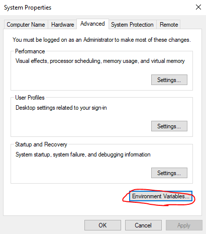

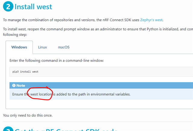

  • Well, the manual install turned out to have incomplete documents too. I created an NCS folder as C:\Nordic\NCS. After I installed west, it asks me to add the west path as below, but I don't know how to do that. Can you explain?

  • You could open "Edit the System Environment Variable" to add west location to path in the environment variable.
    The NCS folder seems it installed successfully, so you don't need to install it in VSCode again.
