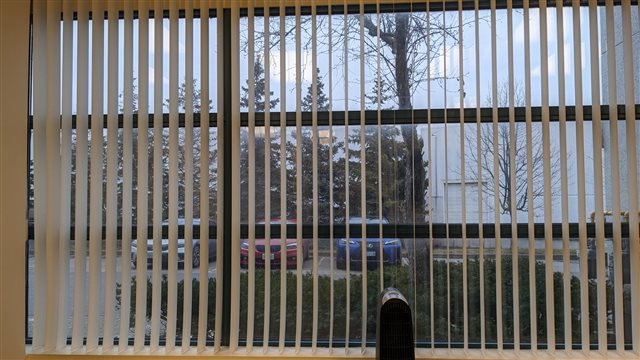

  • Can you provide some information on where you are doing you testing, i.e. the conditions around your device?
    Do you have an nRF9160 DK or Thingy:91 to test with as well?
  • All tests were done by placing the devices on the ledge of a 6' x 20' window where there is no building outside blocking the sky.
    I have a nRF9160 DK.  But that won't be a fair comparison because the DK has a much better GPS antenna.  I used to have a Thingy91.  But it is dead now.  The power supply circuitry seems to be dead.  Anyway, I can try with the DK and give you some results.  Please stay tuned.

  • With the nRF9160 DK at the window ledge, I am getting similar results.

    The DK has higher C/N0 comparing with the Ignion Trio antenna.  But other than that, no big difference.
