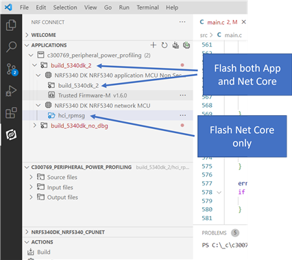

I have a nRF5340-DK card that I want to test with the "Peripheral_Power_Profiling" example. I use the SDK v2.2.0 and VS Code for this. I didn't make any modification to the code, but I get the following error (print of the serial port :

I don't understand, the example worked at first, but after trying to modify the file "...\peripheral_power_profiling\child_image\hci_rpmsg.conf" I got this error that appeared. I tried to put the file back as original, and I also tried to uninstall completely the toolchain and nRF connect for desktop but without success. I still have the issue.
Do you have an idea of the problem?

  • Dear Maxime,
    It is very odd that the those Kconfig's fix your issue, as the peripheral_power_profiling sample does not seem to rely on them to work.
    I cannot reproduce your initial issue on my end. However, while my sample built and works, I see that it runs well without the same two Kconfig.
    My best guess is that in your initial attempts, you only flashed the App Core after accidentally overwrote the Net Core with something wrong. Thus, the application always failed.
    In your recent attempt, you must have now writen a correct image to the Net Core, and thus things work.
    May I ask you to setup another unmodified application based on the peripheral_power_profiling sample, build, and erase and flash, making sure it was done for both cores?

  • It seems that the problem has reappeared, and that my only way to make it work again is to setup another unmodified application based on the peripheral_power_profiling sample, build, and erase and flash.
    What do you think about "making sure it was done for both cores?". How to check it? Just by looking in the terminal?

    Yes, looking at the terminal is one way to do it. You should see that the file being flashed is "merged_domains.hex."
    I initially thought that one could select the wrong line in the Build Configuration panel in the nRF Connect VS Code Extension, and it would only flash the Application Core. However, I double check and it is not the case.
    It seems the only way to accidentally flash only the Application Core is by selecting specific hex file in <build folder>/zephyr.

    The symptom you describe here sound very very strange. Could you please reattempt with a different sample? I can recommend the Bluetooth: Beacon sample, or the Peripheral UART sample.
    If those works well, I think we should then closely examine your flashing steps.
