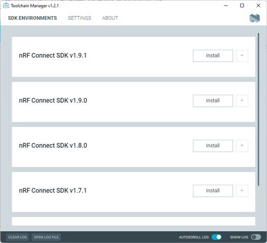

*) The tool manager would not detect SDK versions above 1.9.1, and found this as an unresolved issue on dev zone, so went with the manual install.

    I could, but my initial problem is that Toolchain Manager does not show SDK version beyond 1.9.1:
    Also, I would prefer to have a revision neutral path for ncs, and control revision with git.
    rgds Tage
  • Hi Tage,
    This is likely because you use Toolchain Manager v1.2.1, and the current version is 3.12.0.
    If you want to switch, I suggest reinstalling the toolchain manager and maybe nRF Connect for Desktop.

  • Hi Sigurd,
    My nRFConnect is revision 3.12.0, the Toolchain Manager is 1.2.1, tagged 19/10 according to Nordic Github.
    I tried to delete anything nrf in my AppData folder and ran tool manager again - then it worked and showed me v2.2.0 which I could install and build prephiral_bms.
    So I think I am set for now. Thank you for the support. Relaxed
