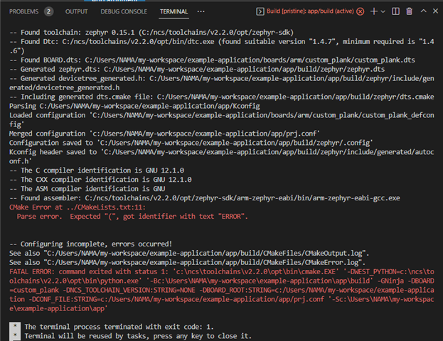

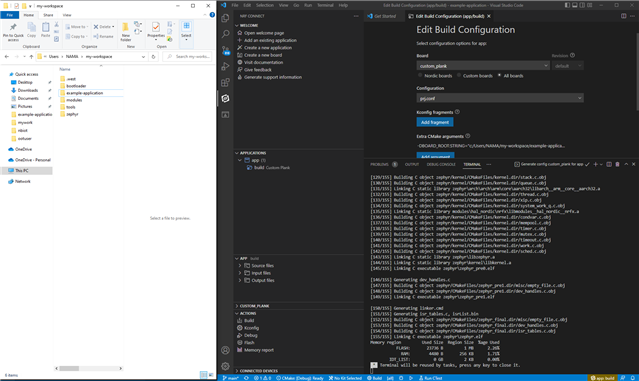

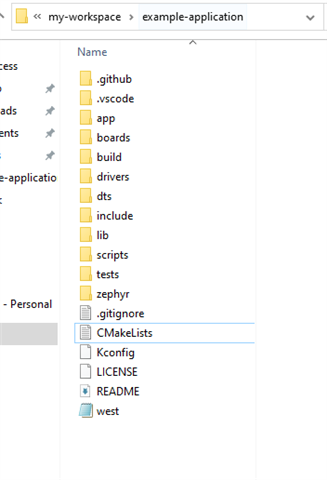

    After successfully initializing, updating and then building the "app" project using the west tool from cmd (command-line), I opened the local repo (example-application) using VS Code, and then added "app" as an application. I was able to compile it successfully. Image below shows the correct compilation using the board present in the parent directory (custom_plank board in this case), and also the folder structure.
    And, yes, now when I put deliberate error in the parent CMakeLists.txt, it gets detected (snapshot below showing the error)
    Removing the error from parent CMakeLists.txt and the project compiles again correctly.

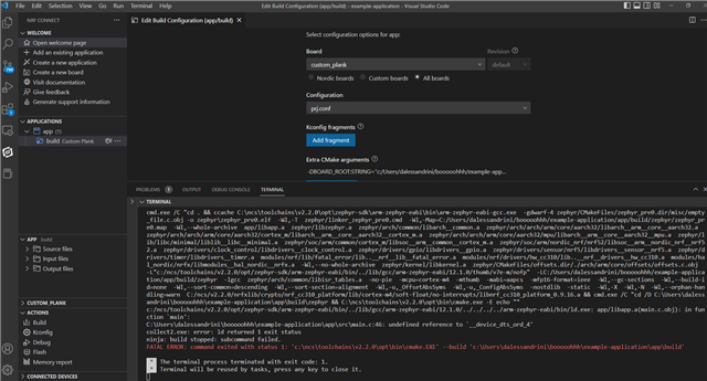

    If I compile the example-application with VSCode I encounter two problems:
    1) The compilation fails because the driver is not found:
    2) If I insert an error in the CMakeLists.txt of the parent folder I don't perceive an error, but the compilation is identical to point 1).
    In practice the problem is always the same: my build system has something wrong.
