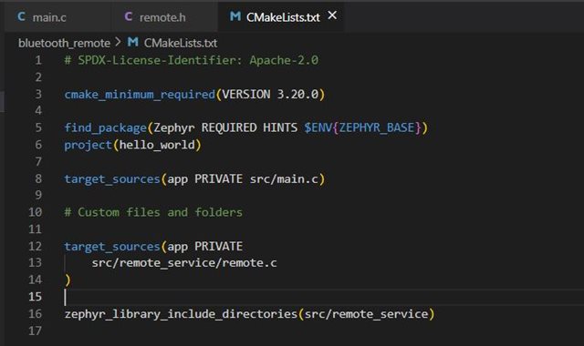

The code written in the webinar for "developing Bluetooth Low Energy products using the nRF Connect SDK" does not work on my nRF5340DK
I first compiled and uploaded the code to my nrf5340dk_nrf5340_cpuapp card. I can't see it broadcasting from my Android device. Output on terminal screen:

When I select and install the code nrf5340dk_nrf5340_cpunet, it appears on my Android device, but data is not exchanged. Text in terminal:

What should I do about this problem I am experiencing?
  • Hi Marte,
    First off, I don't know how Cores are programmed at the same time. Can you help me with this?

  • Hi Cemal,
    If your build directory under the 'Applications' tab in VS Code contains both the application core and the network core, as in the picture below, you will program both cores by selecting the 'Flash' action in VS Code.
    In this case, the sample for the network core is added as a child image. This is done by default in the nRF Connect SDK samples.
    You might have to add the network core sample as a child image in your project. To do this, edit the project CMakeLists.txt and add the child image. Make sure that the path to the network core sample is correct. Here is an example:

  • Hello Marte,
    The build directory under the 'Applications' tab in VS Code is as in the image below.
    I compile the program and upload it to my nRF card as seen in the picture I added below.
    The code in the CMakeList.txt file is as follows. I don't know how to make changes.

  • When I program the program separately, I program the network kernel first. File 'hci_rpmsg' in 'build' directory, under 'Application' tab. This compilation completes without any problems.
    When I program the application kernel, I get the following error on my terminal screen:
    ninja: error: rebuild 'build.ninja': subcommand failed
    FATAL ERROR: command exited with status 1: 'c:\ncs\v1.7.1\toolchain\opt\bin\cmake.EXE' --build 'c:\NordicProjects\bluetooth_remote\build'
    best regards,
    Cemal
