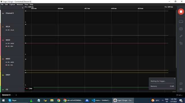

    I have connected the second spi pins which i mentioned  and in the logic analyzer i got this

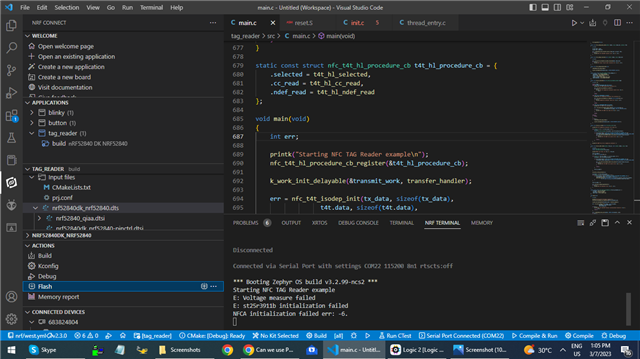

    and in NRF terminal

    You can configure most of the GPIOs to work as SPI pins on the nRF52840, but on the DK some of the pins are by default set up as LEDs, buttons, etc. And I think the first one should be almost okay, except that the CS pin is by default set up as a button, so try changing it to one of the free GPIOs. Full overview, and how to gain control of the ones used for LEDs/buttons, etc. can be found in the nRF52840 DK user guide. Both the SPI0 and SPI1 instances should be usable, as the tag reader sample only uses one SPI instance at all to my knowledge. You can configure it as either.
    Simon
    You said first one is ok but it didn't work for me i connect the second one just now it worked for me NFC field is on now and i just tried another nrf52832 dev kit with write nfc example with an NFC connection so when i keep nrf52832 NFC to ST25 reader it reads the URL data from nrf52832 NFC to nrf62840. but now i want to send those data to nrf connect mobile app over BLE.
