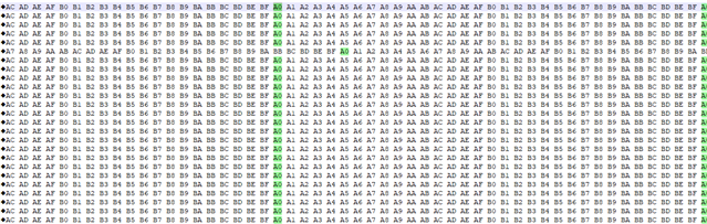

    Another question, when I sending data by uarte, something went wrong.
    you can see that, when I send 5A 0C 03 01 01 for test, I can receive it correctly. then I modify the data in data[3] and data[4], the RTT print is OK, but the uart print is wrong. when i increase the data length, I found that the data from data[3] to data[31] are all 0.
    Also, when I only send data by uart, the data format going run. I init the test_data, then in my uart task, only have the tx code
        for(int i = 0; i<32; i++)
            test_data[i] = 0xA0+i;
        nrf_libuarte_async_tx(&libuarte, test_data, sizeof(test_data));
    but the uart print like this
    BR,
    Lurn
