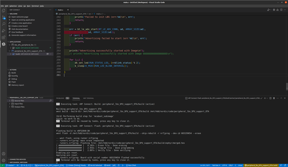

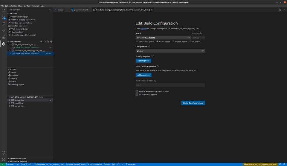

Hi
In order to add DFU function to our custom board (integrating nRF52840) over OTA by using BLE, we refer to the guide named "Adding DFU support to your application" and use the same procedure (include the sample) from the "DFU over Bluetooth" section on nRF52840DK. The upload tool we use is nRF Connect Device Manager (Android-verison 1.5.2).
The result is that when we select the "Test and confirm" option on Device Manager to upgrade firmware (whatever app_update.bin or dfu_application.zip), the state will display "Invalid value (3)" after the procedure is completed. We are not sure if the firmware was successfully upgraded.
In view of this, we searched this issue on Nordic Q&A and found someone with the same problem. The case is here. We refered to the solution in this case to upgrade firmware using "Confirm Only" option. But the result was the same. We recorded two logs. One from nRF Logger app and the other from Minicom. They are as follows.

  • Hi Abhijith,
    I just tried the file you shared, but the result is still the same.
    The screenshot of the build configuration.
    The log of the build result.

    The screenshot of the flash result.
    The log of the flash result.
     *  Executing task: nRF Connect: Build: peripheral_lbs_DFU_support_OTA/build (active)
    Building peripheral_lbs_DFU_support_OTA
    west build --build-dir /mnt/hdd/nordic/code/peripheral_lbs_DFU_support_OTA/build /mnt/hdd/nordic/code/peripheral_lbs_DFU_support_OTA
    [0/4] Performing build step for 'mcuboot_subimage'
    ninja: no work to do.
     *  Executing task: nRF Connect: Flash: peripheral_lbs_DFU_support_OTA/build (active)
    Flashing build to nRF52840-DK
    west flash -d /mnt/hdd/nordic/code/peripheral_lbs_DFU_support_OTA/build --skip-rebuild -r nrfjprog --dev-id 683159654 --erase
    -- west flash: using runner nrfjprog
    -- runners.nrfjprog: mass erase requested
    -- runners.nrfjprog: Flashing file: /mnt/hdd/nordic/code/peripheral_lbs_DFU_support_OTA/build/zephyr/merged.hex
    [ #################### ]   0.282s | Erase file - Done erasing
    [ #################### ]   2.954s | Program file - Done programming
    [ #################### ]   2.897s | Verify file - Done verifying
    Enabling pin reset.
    Applying pin reset.
    -- runners.nrfjprog: Board with serial number 683159654 flashed successfully.
    Next is the log of the whole process.

              --- WARNING: Using default MCUBoot key, it should not ---
              --- be used for production.                           ---
    CMake Warning at /mnt/hdd/nordic/v2.2.0/zephyr/CMakeLists.txt:1833 (message):
    -- Configuring done
    -- Generating done
    -- Build files have been written to: /mnt/hdd/nordic/code/ble_dfu_peripheral_lbs/build

    The flash command
    west flash --erase
    The flash result
    -- west flash: rebuilding
    Using board 683159654
    -- runners.nrfjprog: Flashing file: /mnt/hdd/nordic/code/ble_dfu_peripheral_lbs/build/zephyr/merged.hex
    [ #################### ]   0.286s | Erase file - Done erasing
    [ #################### ]   3.548s | Program file - Done programming
    [ #################### ]   3.483s | Verify file - Done verifying
    Enabling pin reset.
    Applying pin reset.
