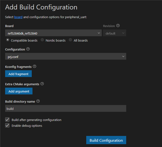

  • Mark,
    There seems to be a confusion in few things here. Let me try to break it down.
    Ability to set breakpoints:
    This is capability of the debugger and compiler. When you have disable the CONFIG_DEBUG_OPTIMIZATIONS in your proj.conf and having set the debug options like below in vscode.
    When debugger running:
    Ability to hit breakpoint and continue after that:
    1) With CONFIG_BT_LL_SOFTDEVICE=y (default now with our SDK)
    This was never working after you enable Nordic BLE stack. Not with our older baremetal solutions and not with newer zephyr RTOS based solution. We always had a limitation that application does not halt CPU or mask the RTC0 interrupt more than few us. There are lots of explanation on this in the devzone. There has never been a confusion that without Monitor Mode Debugging (MMD) you cannot hit a breakpoint, hit the continue button and expect that the debugging will work without assertion. This assertion is by design from the softdevice architecture.
    2) With CONFIG_BT_LL_SW_SPLIT=y
    When using this option, hitting breakpoint and continuing after that was working until Zephyr controller also added similar limitation in this commit. These changes were pulled into our nRF Connect SDK most likely in the release after v2.1.3. So this means that after that release both Zephyr Controller and Softdevice Controller will ASSERT if the prepare signal is found to be delayed (only hapens when CPU is halted or the context of prepare is being masked)
    In your case, when you say that it was working, most likely you used Zephyr controller ( CONFIG_BT_LL_SW_SPLIT=y) before this change. And now with later revisions than v2.1.3, it does not matter which controller you use, you cannot have your breakpoint hit (leading to CPU hlt) and continue to debug without an intentional ASSERT.
    I hope this is clear now.
