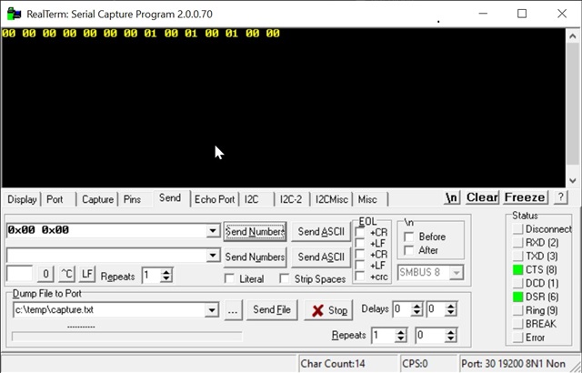

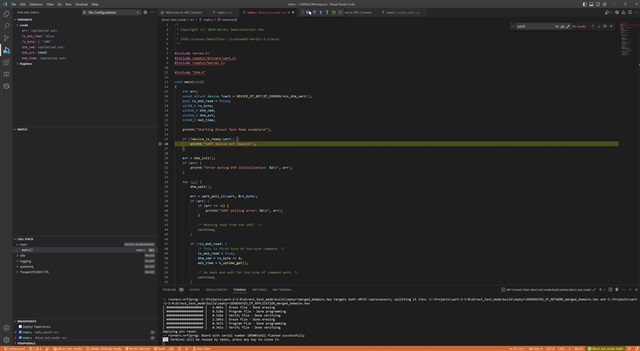

It seems the example uart0 device tree is not configured correctly for this board and main.c !device_is_ready(uart) is true as shown in below screenshot. I used Teraterm with baudrate 19200 and I had no activity. Please let me know what could be the problem here. Thanks.

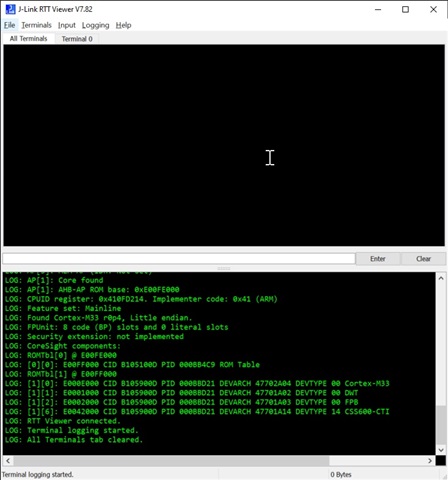

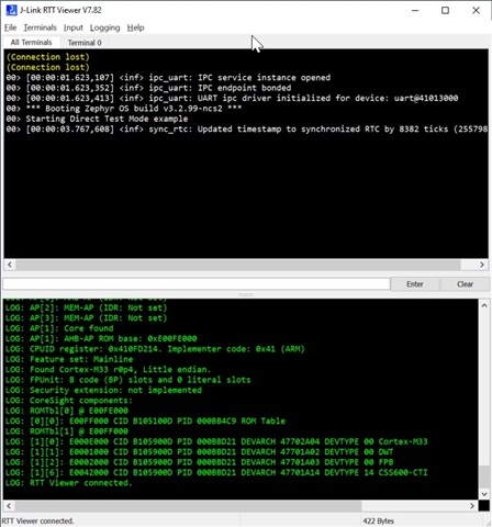

    I switched to RTT and running on NRF5340 DK PCA10095. The only connections I have are J2 and J3. However, I still have UART device is not ready error. RTT trace:
    Connected via RTT with settings mem-address:auto
    SEGGER J-Link V7.82 - Real time terminal output
    J-Link OB-nRF5340-NordicSemi compiled Dec 3 2021 15:46:49 V1.0, SN=1050031422
    Process: JLink.exe
    [00:00:00.000,793] <inf> ipc_uart: IPC service instance opened
    [00:00:00.100,982] <err> ipc_uart: IPC endpoint bond timeout
    *** Booting Zephyr OS build v3.2.99-ncs2 ***
    Starting Direct Test Mode example
    UART device not ready
