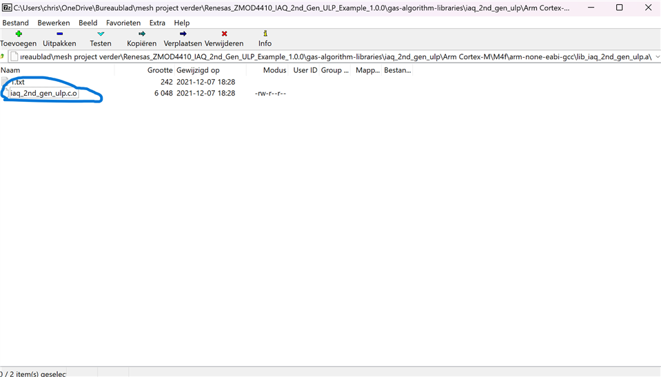

    I am working with a renesas sensor which has a library that needs to be stored.
    I want to put this library directly in the linker script so I can know where it is placed and which RAM sections need to be powered.
    However, Nordic uses a custom Linker script that is translated to a normal script when compiled.
    The problem here is, I have no idea how to use or edit this script. So can you tell me and show me how I edit the existing linker script (flash_placement.xml) so I can put the object file directly in the linker?
    So I want to connect this file to the linker. It is 6048 Bytes.

    If you want to integrate a library into your project, shouldn't it be on Flash memory and not on RAM? Or perhaps there are some special functionalities that you need on RAM?
