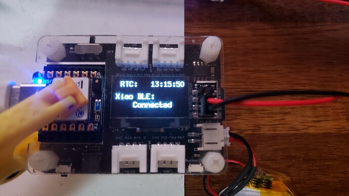

    So I recently started on the NRF_SDK path and i had the same thought of an Overlay ? or DTS file for the Hardware description based off of the schematic. I have a self test Drag&Drop Uf2 file and the ino file for it on the seeed forum. I lights the LEDs,Test the Flash , Tests the SD card (for a fatfs formatted sd card inserted), displays the results on the OLED I2C display , the buzzer is A3 plays a sound. I did find while testing , sometimes it was better to use the GPIO pin numbers in the sketches to get some to work. the self Test also spits out the Device number , MAC address and sets up a BLE central for LED control.Here is the link to the posts if it's allowed
     I want to start making the same test for it using the NRF_SDK so I'm just beginning.
    I have an nRF52840DK and a Nordic Dongle, and the Xiao SWD expansion board and connect them together here use the JLink with the SDK and Nrf_for Desktop Programmer no problem. Built the blinky and sent to both devices.
    The SD is SPI interface and the CS D2 or GPIO P0.28
    The serial output looks like this.:
    Power ON
    Xiao Expansion board and MCU check & Test compiled on Aug 13 2024 at 00:45:24
    Processor came out of reset.
    Selected MCU: nRF52840
    Xiao Unit: 0993
    Playing startup sound
    RTC Date & Time is:8/7/24 12:50:34
    Testing R G B LED - RED, GREEN, BLUE...
    Initializing SD card...Card Mounted
    Card type: SDHC
    Volume type is:    FAT32
    SD Volume size (Gb):  29.12
    Read I2C
        SDA pin: 4
        SCL pin: 5
        I2C address: 68
    Xiao MAC: 93:8E:19:D7:65:53
    Advertising Bluetooth Device
      as: Xiao 0993
    ---END---
