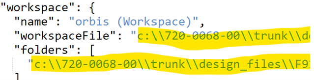

      "workspace": {
        "name": "orbis (Workspace)",
        "workspaceFile": "c:\\720-0068-00\\trunk\\design_files\\F9160\\APP\\orbis.code-workspace",
        "folders": [
          "c:\\720-0068-00\\trunk\\design_files\\F9160\\APP"

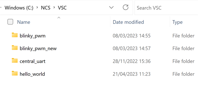

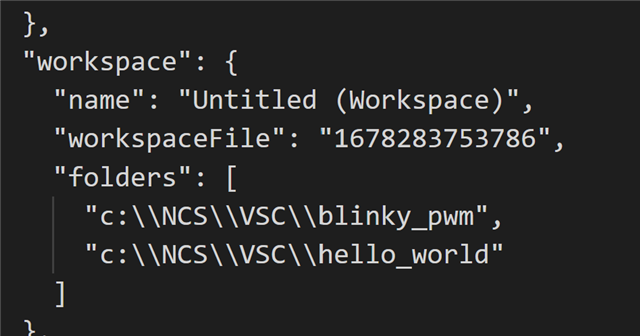

  • Hi Howard,
    Since your SDK and toolchains are installed within the c://NCS path, it is always recommended to create a folder of your new vscode applications within the c://NCS path.
    For eg., my folder is like this like this:
    I have created a folder VSC within the NCS path. And this is how my support information looks like:
    Please try like this and if this doesn't help, then I would say this might be because of a faulty update. Maybe you could try updating your SDK once more via the Toolchain Manager. In case of further queries, I would suggest you to create a separate ticket as this seems to be a separate issue and in order to help future seekers as well as to keep Devzone clean.
    Best Regards,
    Priyanka
