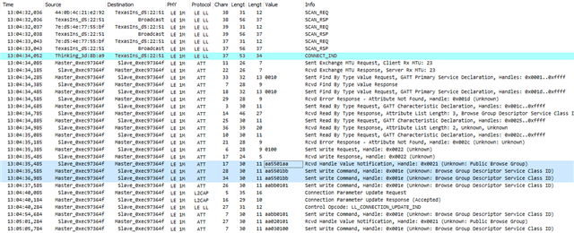

  • Yes, indeed I have both - the black-box central as well as the black-box peripheral (the one I'm going to substitute now).
    After CONNECT_IND (central) and exploring the GATT profile, the peripheral has to send a special value (probably in a short opened time window). After receiving this cookie the central sends another special value, so the peripheral knows the central fits. Only this way both sides keep the connection, otherwise it will be dropped.
    Unfortunately my central "forgets" to enable notification - the channel, where the cookie from the peripheral is expected.
    The image taken from wireshark shows, how to connect successfully - both black-boxes (central and pheripheral)
    The "aa5501aa" is the cookie sent from peripheral to central. The central answers 2x with "aa5501bb"

  • Hello Edwin,
    finally I've managed to fake nearly all of them - advertising packet, scan response, device address, GATT profile 0x180A (DIS) and 0x1000 the customer functions, where the secret cookies should be exchanged.
    For GATT inspection I did use the GATT Browser from Renesas (very useful because displayed data do not disappear when device is disconnected - but don't forget to switch to light theme on iOS, otherwise the font vanishes...).
    Some entries in 0x180A (DIS) are missing, and I couldn't figure out how to add a user description to each GATT function.
    The black-box central tries to connect to my nordic implementation, and after a few attemps it works sometimes. But it seems to me to be a timing problem - the central opens a short timing window after it has discovered the peripheral GATT profile - this small window I have to hit with my cookie.
    But when thsi window opens depends on how much traffic is on the air.
    So it would be greate to have an event when GATT profiling is in progress or finished - is there a possibility to get a user callback function involved?
