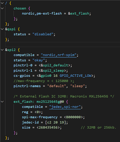

    1st Step> Modify overlay file as per below:-

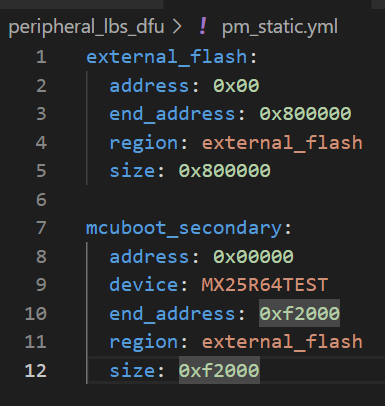

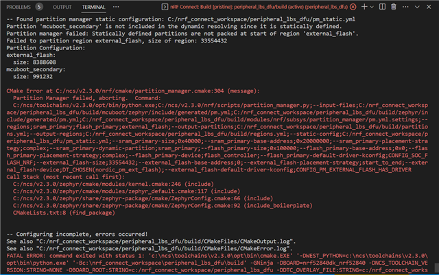

    3rd Step> try to Add pm_static.yml file to project directory. it is having following content.
    4th Step> but due pm_static.yml file error been generated as seen below so I just changed the name from pm_static.yml to pm.yml file. all the errors resolved.

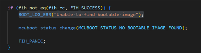

    5th step> Flashed the code through J-Tag. no response seemed from firmware. I try to debug and put a breakpoint at main itself, It never came here. it looks like it is trapped here as below
    I was thinking if it is done successfully and responding, I will change again some lines of the code and make binary file app_update.bin and then upload through device manager app. but unfortunately I couldn't reach up to here.
    Can you please guide me step by step which step I am doing mistake.
