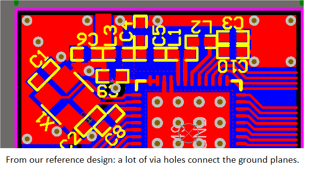

A typical design consists of two ground planes; a top ground plane and a bottom ground plane. Both ground planes should preferably be as large and solid as possible. Ground is the reference of the system, the impedance of the antenna should for example be 50 Ohm with respect to ground. The larger the ground planes are, the more it takes to disturb them. The two ground planes should be connected using a lot of via holes. Our reference designs show what the distribution of the via holes may look like.
