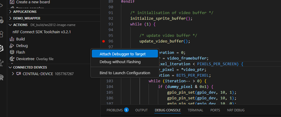

Method #3 - Attaching to running a target
Finally, is it possible to debug code running in the FLPR code, in a full system with the application CPU running as well? The answer is YES, and the way to do it is by attaching to a running target.
In this scenario you will build your application and flash it in your target like you would do it in a non debugging situation. Then, once it’s running, click in the three dots next to “Debug”, and select “Attach Debugger to Target”.
Attaching to a running target
When you do this with the main build selected, you will get an extra prompt, asking what domain you want to debug. You should see in the list one for your application CPU, and one for the FLPR. You must select this last one.
For debugging you will need the build symbol information. The best way to ensure these are present is by setting the corresponding Kconfig option in both prj.conf files, by adding this line to them:
CONFIG_DEBUG_OPTIMIZATIONS=y
When attaching to the target, you may get a warning that the build does not have the symbols. If you added the previous config option, it should have it, so it’s safe to click on “Debug Anyway”
As the debugger will attach to a running FLPR, it will start in a running state. If you pause the execution, is very likely if you will find it in a wfi instruction, waiting for an interruption.
From there, you can navigate through your files, put a couple of breakpoints, resume execution, and that’s it, let the debugging begin!
It’s important to highlight that you cannot have a debug session running in both the application CPU and the FLPR at the same time - so the code in your application CPU should deal with the fact you will be halting the execution of the code in the FLPR, and not be impacted by that scenario.
